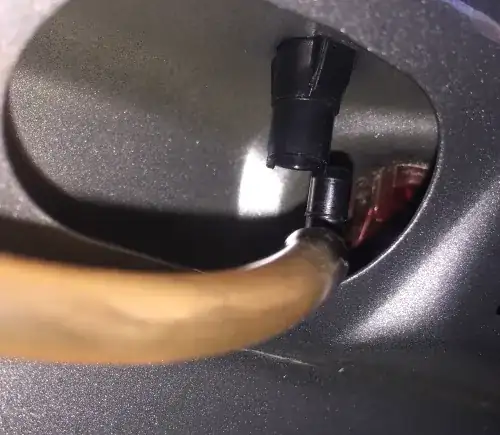

I have next issue: a hose of the rear window washer fell off and I have no idea how to put it back. I tried just shove it back by force but without result. Looks like it has a clever way to put the hose back to the connector.
Have anybody idea?
Have anybody idea?
You can get some “softer” silicon pipe that bends easier and use a straight connector.
One trick is to remove the jet and as you push it back into the hole , you push it into the pipe at the same time - this gives effectively more space to work...
