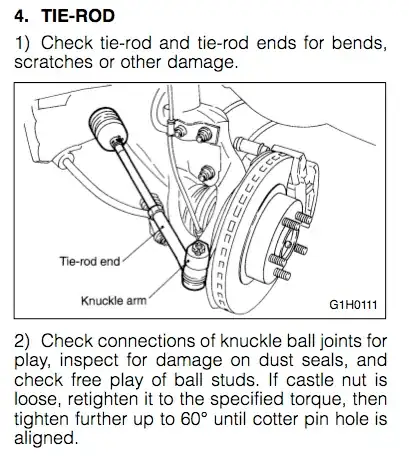

I just stumbled across this entry in my factory manual, which says that overtightening is the correct procedure.
The safe margin is given by rotation rather than torque, however -- up to 60˚ past the point where the specified torque is reached.
