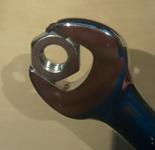

Duct tape is your friend here, you simply use a piece to cover the back of the ring so the nut can't fall through. The glue will also hold the nut in place while you maneuver it.

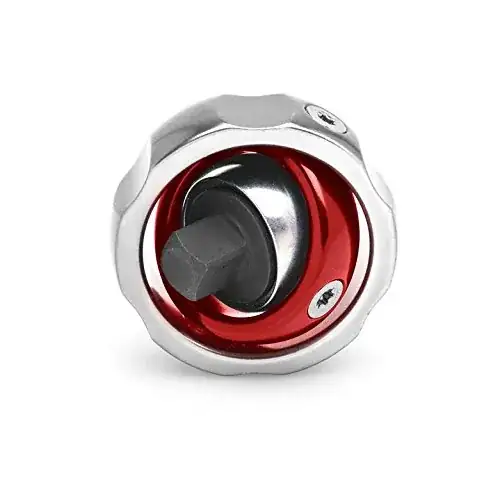

This isn't a trick, but a possible tool for the future. A ratcheting gimbal palm wrench is very handy for hard to reach location, if you can get a hand to the location you can ratchet it in or out. You can't get the same torque as you can a wrench, but you can twist it on pretty tightly and then finish it up with something else if hand tight won't do.

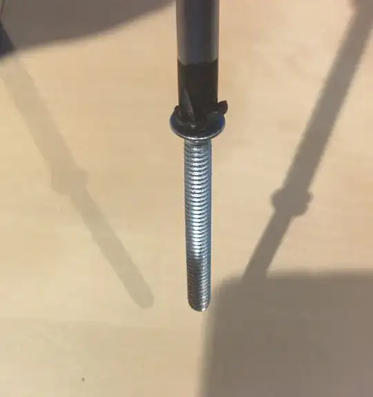

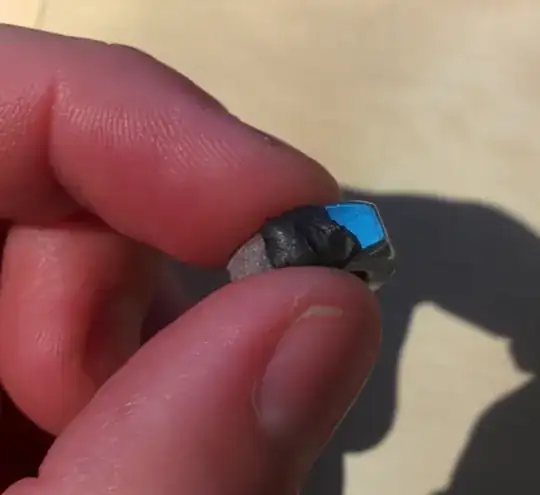

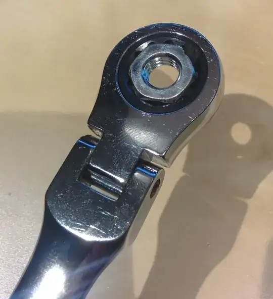

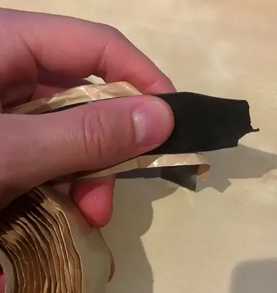

Rubber mastic tape (for example, 3M 2229) is my favorite solution. Be sure to get the stuff that's just mastic, without any kind of backing. As an anti-example, 3M 2228 has a rubber backing.
Just a small pinch of the stuff will stick to the nut or bolt but can be pulled away when you're done. It sticks well enough even if the parts are a little greasy: just wiping them with a rag is sufficient. If more hold is required you can pack the stuff into a gob all around the tool and the fastener.
Works for screws too: slotted, phillips, torx, you name it.
Also works for retrieving dropped fasteners.
In your case you may also find a ratcheting box ratcheting box wrench / ring spanner to be useful. Just be sure if you decide to use the same tool to remove a bolt, you don't loosen it so far you run out of clearance to remove the tool: you may have to decide between destroying the tool, or figuring out how to remove a broken bolt in a tight space. Not that I've ever had this happen to me...
