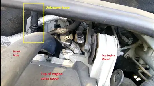

There's a hose behind the engine that connects to some fitting that passes through the firewall on an old Volvo XC90 that seems to be leaking oil. I can't identify what that part is.
Does power steering fluid have any need to go past the firewall? What hoses and fluids can one typically expect to traverse the firewall of a vehicle?

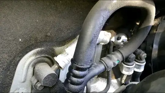

Hose in perspective of the engine
Large segment of hose shown

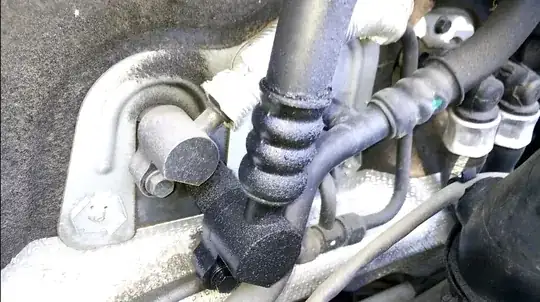

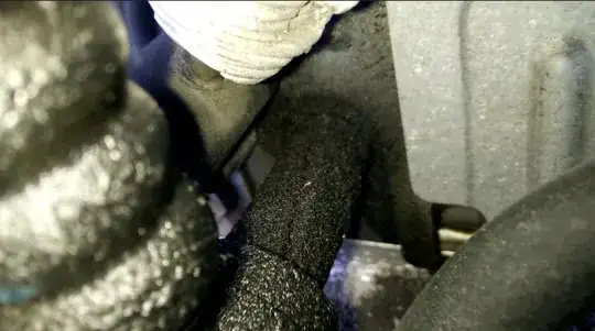

Close up on the hose attached to something passing through the firewall
Close up to oily fitting

That is an air conditioning refrigerant pipe. Does the air-con work?
