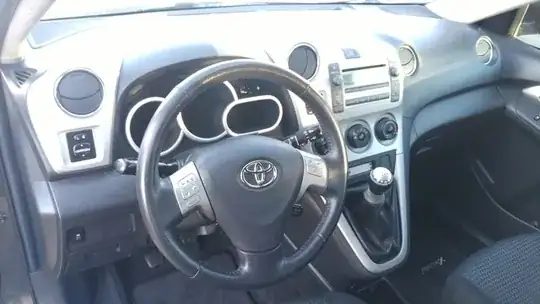

You can see in this image, there is a switch located in the panel to the left of the steering wheel. It looks as though it could be for stability control (who knows!). The point being, there are switches which will fit in there, it's just a matter of hunting them down and seeing what would work for your needs.
