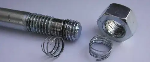

A stripped thread is one in which the threads of the bolt or nut or both have become so damaged as to be incapable of holding the loads for which it was intended. One can strip threads by over-tightening until the nut or bolt head turns but no additional force is applied to the joint being fastened.
Such damage is often visible as an area of smaller diameter, as the "raised" threads are gone.

stripped threads on bolt
Image above credited to tribology-abc.com
