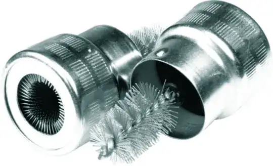

As others have noted, corroded or broken battery terminals could be the cause if the battery voltage seems good. In that case you want one of these, available at any auto parts store:
cleaning tool
Use it to clean both the terminals on the battery itself, and the inside of the clamps. Then apply conductive battery terminal grease, reattach, and tighten.
