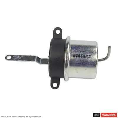

Your truck should have a vacuum actuated blend door actuator which looks something like this:
One of four things (I can think of) are going on with it:
  1. The vacuum line to the actuator is pinched or broken.
  2. The actuator itself is worn out.
  3. The linkage from the actuator to the blend door has become disconnected.
  4. The vacuum actuator switch (the part in the dash) has gone bad.
From the sounds of it, the blend door in your truck is stuck so it is always forcing air through the hot side (ie: the heater core) and into the cab of the truck. You'll need to figure out where it attaches, but it should be fairly accessible from the bottom of the dash on the passenger side of the vehicle (this is the most likely place for it to be). If you switch the position from the temperature control on the dash, you should be able to hear the vacuum noise as it tries to move the actuator. This should lead you to where the issue is most likely at.
