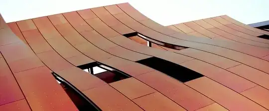

Likewise, stainless steels can be textured and coloured: enter image description here
