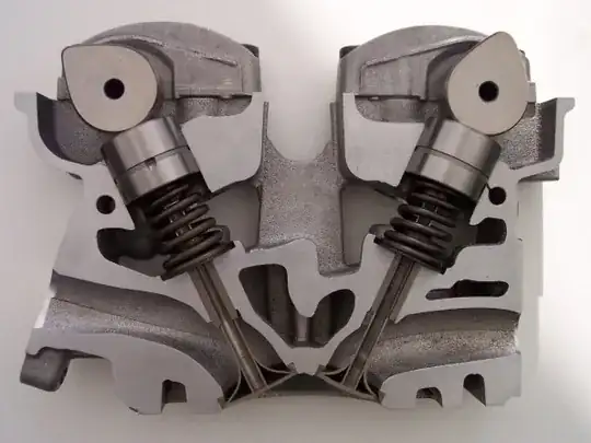

Another point of interest is that you have a shim and bucket valve train. More on that later.
Here is an image of a shim and bucket valve train. Notice that there are no rocker arms or push rods. The cam acts directly on the bucket and shim which acts directly on the valve stem. You adjust the valves by changing out different shims to get the appropriate valve clearence. In this image, the shim is below the bucket. This is what the CBR has. It's called an Under the Bucket Shim.

All you need to do is adjust the valves. You remove the cams after measuring everything out with a feeler gauge and document the gaps and then subtract the value you need to get valve clearance and goto the Honda shop and order up some shims. Be sure you put the shims in a cupcake baking pan or an ice tray, something where you can keep track of where they go, exhaust cylinder 3 etc...
