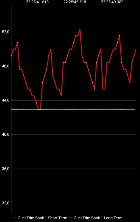

  • Not so for the fuel trims: enter image description here
  • At the moment I have no possibility to check the fuel pressure. The fuel filter never got replaced. Since the change interval for the filter is 240KKm (actual mileage: 85KKm) I want to exclude the filter.
Question
What would be a possible explanation for the high fuel trims? Perhaps the MAP-sensor or the IAT sensor? I'd like to exclude the O2 sensors as the values seems right (at least from my limited perspective). Could somebody purpose further checks?
