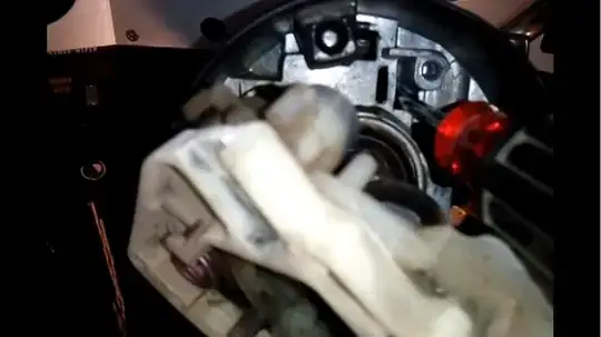

Once the steering wheel is off, there will be a plastic cover which you can remove fairly easily. When that is off, there is a clocking mechanism which has to come off. If you have strong thumbs, you can press down on this and remove the c-clip which goes around the steering column, which will release this clicking plate. It should look something like this:

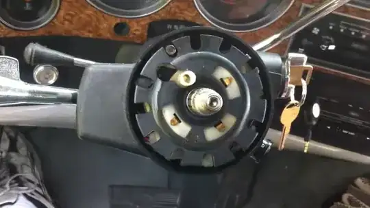

Then you'll need to take the white piece out which is the signal return (well, get it out of the steering column, anyway). Then you should see the metal structure underneath. Place a thin bladed screwdriver as shown in this image:
There's a tab which is in the slot there which you're going to press with the screwdriver which will release the ignition cylinder. You should actually be able to stick a screwdriver into the large hole left behind by the now missing cylinder and start the truck very easily. Because of this, you'll not want to leave it like this long ... very easy to get the truck started at this point.
