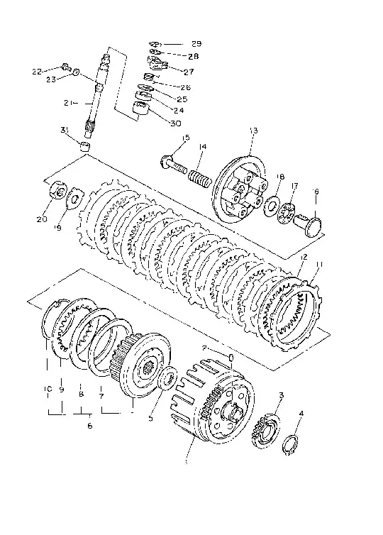

Here is a clutch diagram for your bike. enter image description here
