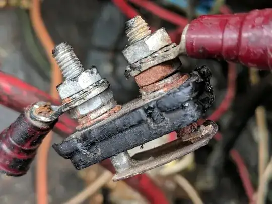

Here is something that was wrapped in tape and comes off one of the two batteries in the front bay. The two batteries are separated by isolators but can be bridged together in parallel using an "emergency start" button next to the steering wheel for an extra boost of power.
It looks to me like this is maybe a thermal switch or fuse? You can see a contactor on the bottom right of the picture. Whoever did this was clearly making it so the contactors were always connected. I can't find any good comparison pictures using google images, searching for "thermal switch" so maybe that's not what it is. Does anyone have any idea? I'd like to know if I should find a replacement for whatever this is for or of I can simply switch it out for a single wire.

Thanks to @Moab and my neighborhood auto parts store, I found what I was looking for. It looks to be a crusty old automotive thermal circuit breaker without its case.

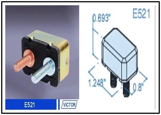

Here is what a newer one looks like with the case on:
