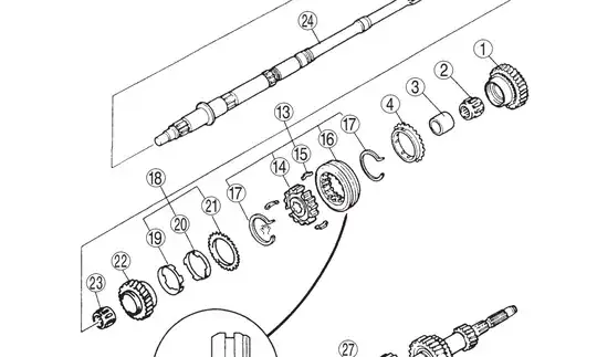

My gearbox is a R15M-D. And a diagram looks like this,
Part #1 - 1st gear
Part #4 - 1st synchroniser ring
Looks like it does have synchromesh on first.
