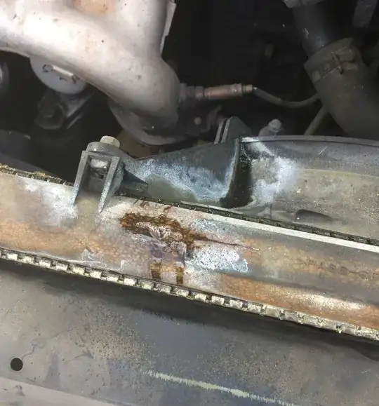

I have a 1995 Toyota Camry. When I cut my car off from driving. It leaks and make a little noise. Today I lifted the hood. I should’ve been did that. And saw this crack with liquid bubbling. I’ve been driving it like this about 40 miles a day. It also leaks under the car.

That is a crack in the upper tank on your cooling system Radiator, the radiator needs to be replaced soon or engine damage will result.
They do this when they get old, the tank is made of plastic and eventually will develop cracks.

What you should do until you get this repaired is fill up the radiator with water whenever the engine is cool. You need to replace all the coolant/water that falls out. If you drive with an empty cooling system you won't have a good time. Good luck!
