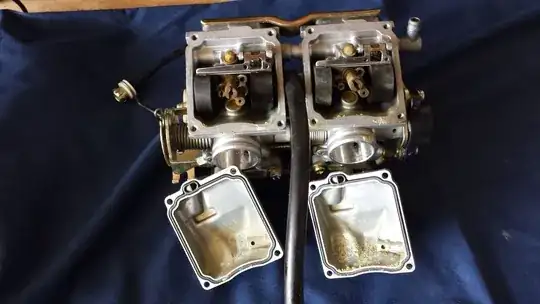

The attached picture shows (right float bowl) accumulation after just a week after cleaning and reassembling carbs. Just after opening the bowls, they dried bits seen in the picture were similar to gel blobs.
What would cause this type of coagulation?
The gas in the tank is fresh regular, with Berryman's B12 #2616 Total Fuel System Cleanup added to aid the previous carb issues I thought I might be running into.
Mikuni twin carbs

manufactures of carburetor gas engines such as honda, brigs and straton ,preditor do not recomend using alchol gas in any of their products as it will void the warranty also kawasaki and other carbed engines do the same..unless your fuel system is setup to use straight alcohol...most all older carbs and many new carbs wont tollerate it...ive seen it many times

I run 100% alcohol and it does not gel or change colors, looks to me like bad/cheap gas. I would clean the system and try a different source for your fuel.
