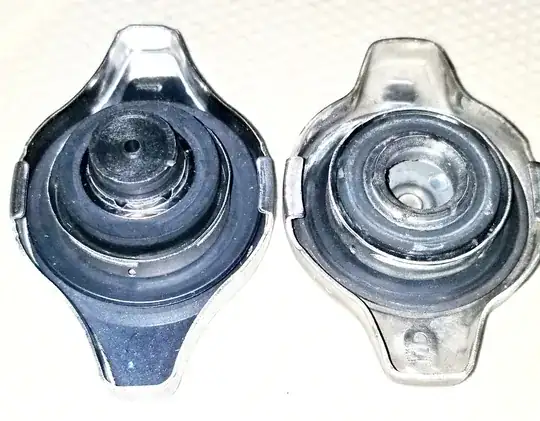

enter image description here Check radiator cap, too. Defective one on the right is missing the black seal in the center. This caused overheating and a buildup of pressure.
