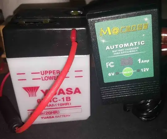

I am trying to charge this battery with this charger: enter image description here

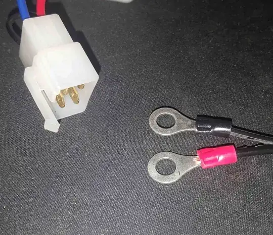

However The connectors are as such: enter image description here
The battery is 6V, 4Ah The charger operates at 6v, 1A
Without an obvious way to connect these im a bit stuck.
How can I hook these up to charge safely?

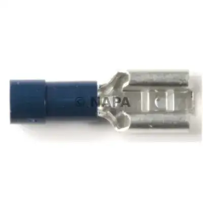

Cut the ring terminals off of the charger and crimp on a pair of 1/4" female flat spade terminals, be careful to note and mark the red + lead, they need to be connected to battery in proper polarity.
Terminals you need:
https://www.napaonline.com/en/p/NW_723104
