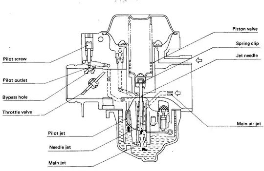

You can drill out the air screws at the tops of your carburator CV cover closest to the head. They are aluminum. Be careful, your drill bit will go right through them and the aluminum plug over the air screws might just come off in the bit. That's ok, just don't penetrate to deep, you will hit a brass air screw if you do and drive it into your carburetor breaking off the the pin at the end of it. Once you have access after removing the aluminum plug blow out the aluminum shavings. Turn the air screw down all the way and turn it out 1.5 times as a starting point. Turning it out makes the pilot/idle circuit operate leaner, more air for more turns out.

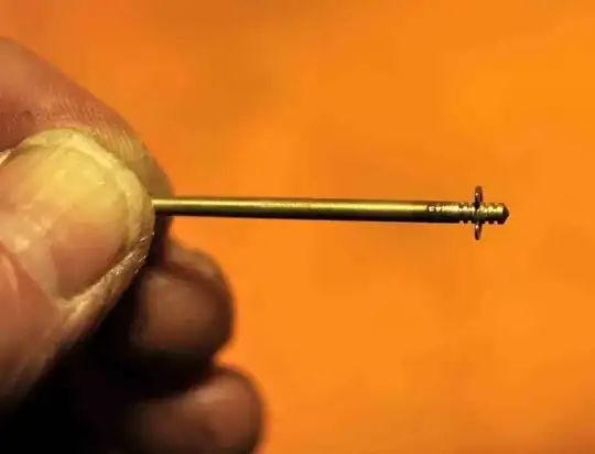

For higher RPM you will need to order the next size up main jet and a jet needle that has notches at the top. The jet needle goes into your throttle. The jet needle rests at the bottom of your CV piston valve.
You will raise and lower the needle by changing the clip position on the jet needle. If you want to make it richer, drop the clip to a lower notch. If you want to make the engine run leaner, raise the clip to another slot to drop the needle down lower into the main jet stand.
This procedure will allow you to tune the carburetor.
K&N makes a jet kit for your bike. Jet kits are typically applied to carbs after a free flowing aftermarket pipe is installed to enrich the system. In your case, it's just a modified stock exhaust turned into a free flowing system. It should work just fine.

CV Carburetor Image
Notched Jet Needle Image
