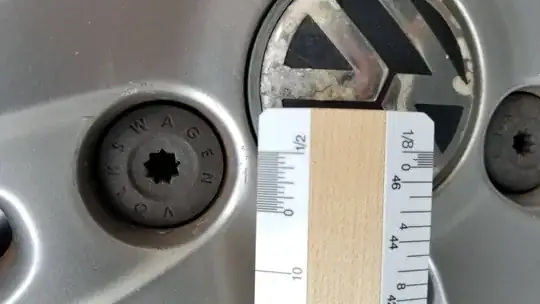

Can anyone tell me what to use to get this wheel off? I have a breaker bar but the lug bolt seems to be missing from the car. Picture of Wheel
It has 9-points, so it is not an XZN triple square like I thought.
ZX9
  • 143
It's a plastic cap that covers a 17mm wheel bolt. There should be a little hook tool with the tools that came with the car to remove them. Or you can use a small screwdriver.
