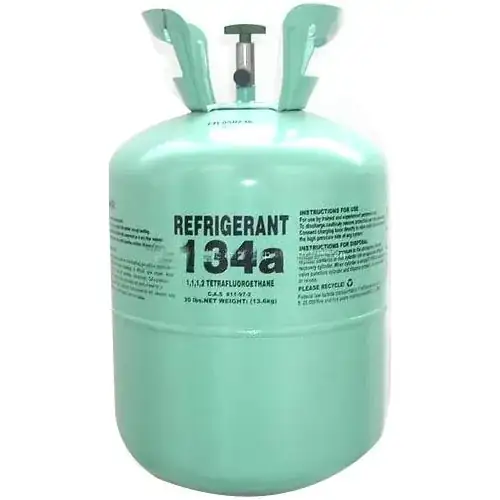

Rather than act irresponsibly and release it to atmosphere, I would like to know if it is possible to use a spent refrigerant bottle (the disposable kind like in the picture below) to store the excess refrigerant so that I can take it to a specialist workshop that has the ability to recycle it at a later date.
The thing I'm not sure about is whether these bottles can come with a one-way/check valve that ensures they can only be emptied, not refilled.

Example R134a bottle

After finally seeing exactly what you are trying to use to store the R134a, I don't see any reason why you wouldn't be able to. This type of bottle has the valve to shut off the flow (either in or out) of the bottle. Once you get out of the system what you need to pull, shut the valve and be done with it. With as large as the bottle is (originally I was thinking you were trying to use the smaller 12 or 16oz cans ... ), the only problem you'll need to worry about is pulling too much refrigerant out of the system. Anyway, yah, go for it. Looks like you are trying to be DIY and environmentally friendly at the same time.

This 30 LB refrigerant tank has one way valve. You may only discharge it, not refill it. You may cut out very top of rim of valve just where it curves with dremel. It will give you ability to unscrew stem out of valve. Then you will need to remove spring and metal ball. Then screw stem back to valve and now you may refill it. MAKE SURE THERE IS NO PRESSURE LEFT before you do it!!! But actually why bother? You will have to went out very little of refrigerant out of car AC. Not a big deal considering that million of cans of this same refrigerant(R134A) vents out by people at home every day. How? You will be surprised that "compressed air" sold in Office Depot store to clean computer keyboards is actually R134A. Read label :))
