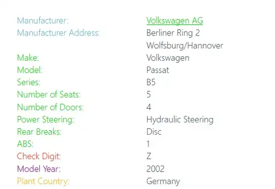

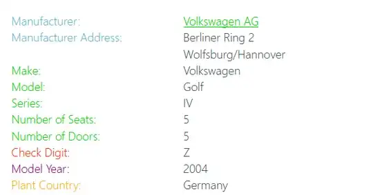

Details of the donor vehicle of the new engine Details of the donee vehicle
