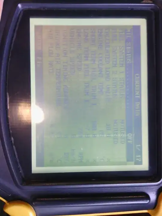

My 1998 Mazda 626 GF 2L ATX has zero ignition timing at idle when fully warmed up causing a rough idle condition. I've replaced the faulty O2 sensor with no effect on the retarded timing and replaced the Neutral inhibitor switch due to testing identifying poor continuity. Have also replaced the PCM with another from an identical model but it still has retarded ignition (zero) timing at idle when warmed up. Car always has 10-12 degrees of ignition timing at idle on cold start then progressively drops to 0 degrees ignition timing at idle once reaching full operating temperature and engine fan cuts in. If anyone has successfully managed to resolved this issue with the same model car please let me know.enter image description here

Based on your scan data, at 749 RPM your engine is drawing 4.1 g/s and load is 18.8%. That MAF reading is suspiciously high, and I would bet that if you take a look at your IAC percent open, it will read 28.5%, which is fully closed. I'm also guessing that either you have opened up the idle air screw to try and raise the RPM and smooth out the idle, or that you've got carbon build up in the IAC preventing it from fully closing.
Under these circumstances, the ECU will retard the timing ( and close the IAC ) to bring down the idle speed to what it's target is.
So close the idle air screw some and I bet you'll see the timing get more positive.
