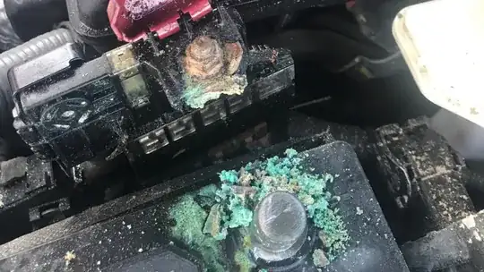

Image of Copper Sulfate Corrosion on Car Battery
Greenish/Bluish
The picture above is of the positive terminal. The Greenish-Bluish "fuzz" is likely Copper Sulfate that’s been exposed to a bit of moisture. This is formed when the copper in the terminal-clamp reacts with the lead in the battery terminal, helped along by the transmission of electrical current and sulfuric acid from inside the battery, and maybe seeping out a bit from various seams. This known as a Galvanic Corrosion (Bimetal Corrosion)
The chemical reaction looks like this:
Cu (s) + 2 H2SO4 (ℓ) → CuSO4 (aq) + 2 H2O (ℓ) + SO2 (g)
This copper sulfate does not conduct electricity very well, which is why battery performance will degrade (and, with that, you’ll get other electrical issues), and why it’s a good idea to clean this stuff off the terminals and groounds. Baking soda and water are good for removing the corrosion, because the baking soda will neutralize the acidic copper sulfate.

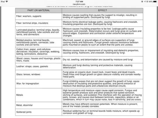

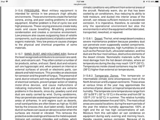

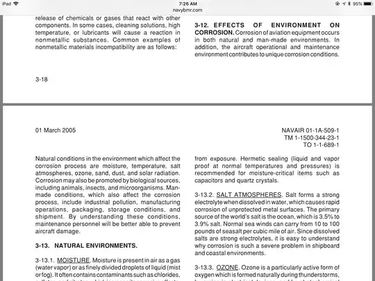

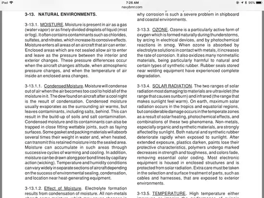

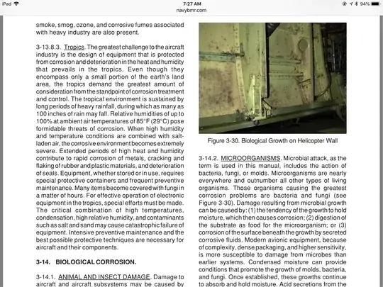

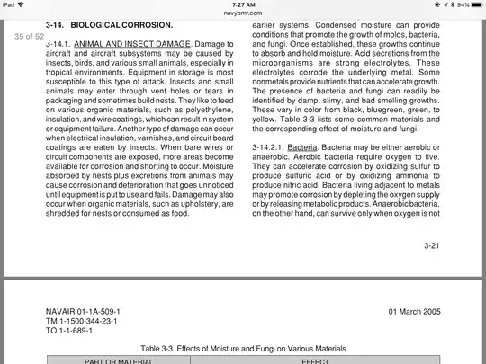

Here’s the navair corrosion manual. If you prefer not to read it then yes seasonal weather changes along with any environmental differences can increase or decrease corrosion.
