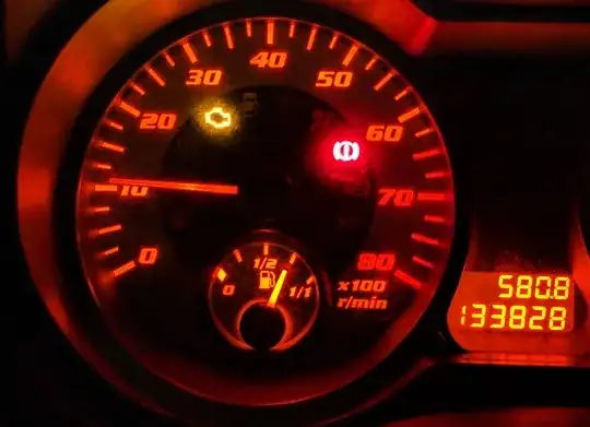

Photo of engine light on:

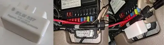

photo of OBD device/port and when I connect it, the device light turns on. enter image description here I believe the socket is in good condition since the device light turns on.

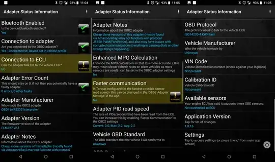

Photo of Torque Pro android application: enter image description here

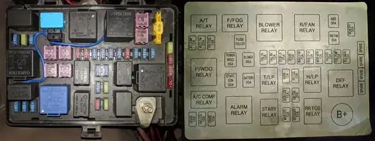

I checked the ECU box and everything seems alright. enter image description here
  • ECU seems working fine since Engine light is On.
  • OBD device working fine too, since app shows that it is connected to device.
so I'm not sure what is the problem.

When a scantool is unable to connect to a vehicles ECU:
  1. Make sure you have power to the OBDII connector under the dash. (Since the adapter lights up, it means you have power)
  2. Try connecting to a different OBDII compatible vehicle. If you can connect, it narrows the problem down to being between the scantool and vehicle.
  3. Try using a different scantool/adapter. There are many cheap OBDII adapters on the market that are just useless out of the box.
