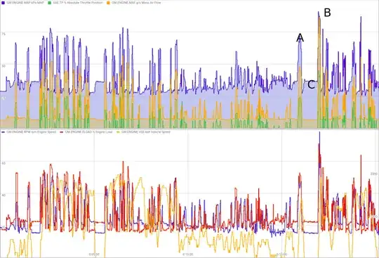

UPDATE: After seeing comments about the need for more data and possible latency problems in the scan tool, I have managed to create a nice graph with more reasonable data.
Both charts are in the same time scale. I wanted to have 2 charts because otherwise lines go over each other too much.
With these charts, things look much better to me than I initially thought.
For example,
  • A: When throttle is at ~25%, engine load is at ~55% and engine speed is at ~2000 RPM, I can see the MAP at ~70 kPa.
  • B: 50% throttle, 100 kPa
But I don't understand C. When idling throttle position is %0, RPM is ~600 and the load is 25%. MAP sensor is at ~40 kPa which makes sense when I compare with engine load. This probably means the engine load is too high when idling, doesn't it?
Any suggestions to provide better data?

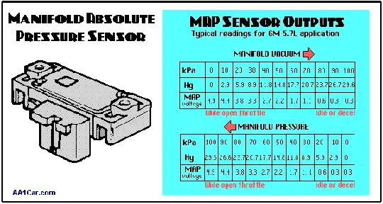

It appears to me your MAP sensor is bad, as the readings of the MAP does not mesh with what this chart I pulled from this website:
According to this chart, as vacuum increases, voltage should go down. Yours appears to be going in the other direction (vacuum goes down, so does voltage), as well as the voltage not being in the range which is expected as per the chart.
As for the map sensor, if this is not a boosted application (no turbo or supercharger), you only need a one bar MAP sensor. From your description, you aren't running anything which produces pressure, so can assume your MAP sensor is stock and only covers one bar.

“This probably means the engine load is too high when idling, doesn’t it?”
There are many factors that have an effect on manifold air pressure at idle. For instance it is common for the MAP to have a variance around 1 inHg or 3 kPa when idling in drive vs park. Also an increased electrical load, your elevation, and engine mechanical integrity are all a factor that contribute to your MAP reading. MAP readings from OBDII data cannot tell you what a vacuum gauge can. Does the vacuum gauge hold steady, flutter, or float up and down?
Looking at C on your graph, it looks like your map is sitting in the middle of 25 and 50 which puts it at about 37.5 kPa. According to an OBDII datalog taken from a known good 1998 Chevrolet k1500 5.7 liter, the average of 41 frames taken at a warm idle, in park, and all accessories off, is 35.76 kPA. (source - pidfusion.net) That equates to about a 0.5 inHg difference in vacuum, and that is nothing I would ever be concerned about.
