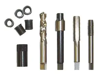

A bit of research on your vehicle shows that the aluminum threads are prone to failure and are frequently replaced with steel inserts designed for this application.
One resource includes the clearly written instructions for installing an insert, which would be purchased along with the cutting tools necessary for the job. I would note that it appears necessary to remove the oil pan to ensure no cutting debris would enter the lubrication system during the insert insertion.
insert kit image
