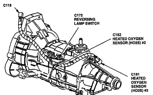

You have a defective reverse light switch, which is screwed into the transmission. C172 in the image below.
Fairly easy fix to replace it with a new one. Disconnect harness from switch, unscrew switch from transmission, screw in new switch, reconnect wire harness.
NOTE: If this does not fix the issue then it is a wiring problem, the reverse lamp circuit is shorted to a hot at all times wire somewhere in the harness.
