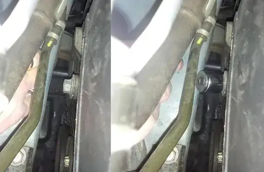

The problem I am having is that I cannot get a socket onto the release nut as there is not enough room between the nut and the fender:
UPDATE: Bolt pictured above is the wrong one - the one I should have been trying to turn is part of the tensioner body and is not really a bolt per se but a "handle" if you will to attach your wrench to (see this video http://www.youtube.com/watch?v=eX27hH39mQM).
I will be trying again when I have time and will update further.

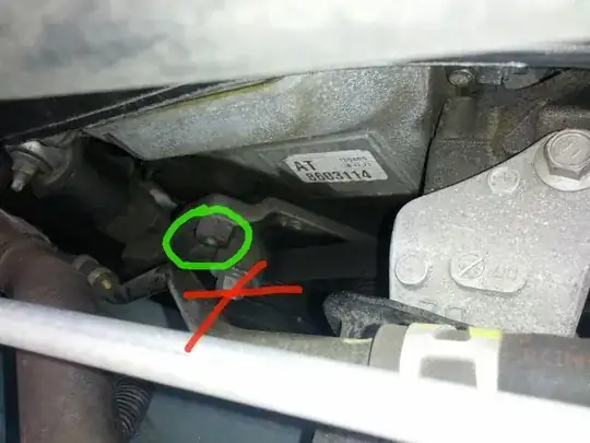

I hate to answer my own question but did eventually figure it out.
Here are the more complete steps to swap the belt:
Prerequisite: locate a belt diagram or draw your own before starting.
  1. Remove the plastic engine cover using 10mm ratchet - this will allow easier access to the tensioner / belt on the left side of the engine.
  2. Find the bolt head that is welded to the tensioner (circled in picture below 2).
  3. Using 19mm socket and ratchet with long handle (or using pipe as cheater bar for more leverage) turn the "bolt" on the tensioner towards the front of the car (clockwise).
  4. Slip the belt off of one of the pulleys and release the tension on the bolt.
  5. Remove the old belt.
  6. Now the tricky part - get the new belt on as per diagram. I started with the deepest pulley and worked my way up until I had the belt on all pulleys except the front top one.
  7. Do step 3 again - while the tensioner is released slip the belt onto the last pulley.
  8. Make sure you have the belt on as per diagram and that the belt is centered on each pulley.
  9. Release the tensioner to take up the slack in the belt.
  10. Put the engine cover back on.
  11. Success!
