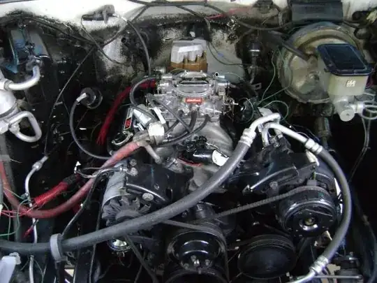

V belts are traditionally found in older motors, where you would have a series of those belts coming off the crankshaft, each to their own individual accessory group (alternator, a/c compressor, etc).
See how the belts are staggered? enter image description here

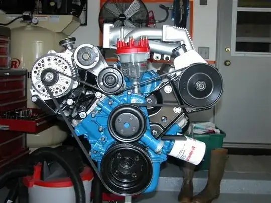

V belts also derive their name from the cross-section of the belt itself. In the first photo above a V belt will ride in grooves on the pulleys. Serpentine belts don't have this same cross-section because as you can see in the 2nd photo both sides of the belt come in contact with various pulleys.
