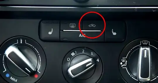

Do you use the circulate feature on your car? This should be turned off. It looks like the image below:
I learned early on that this causes this exact issue in the winter. My theory is that the moist warm air we breath out is circulated over and over and then sticks to the cold windows. When you shut that option off, you are pulling in fresh (dry) air from outside.
