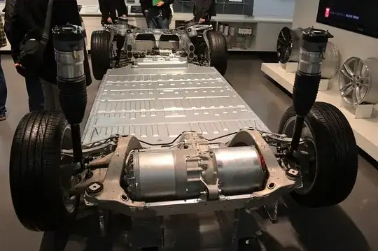

It may just be for packaging reasons. I could not quickly find the gearing, but it likely doesn't matter much. Taking a look at the photo here shows the motor set back on the subframe, it looks like this allows the half-shafts a straighter shot to the differential, and then to the motor. enter image description here
