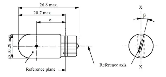

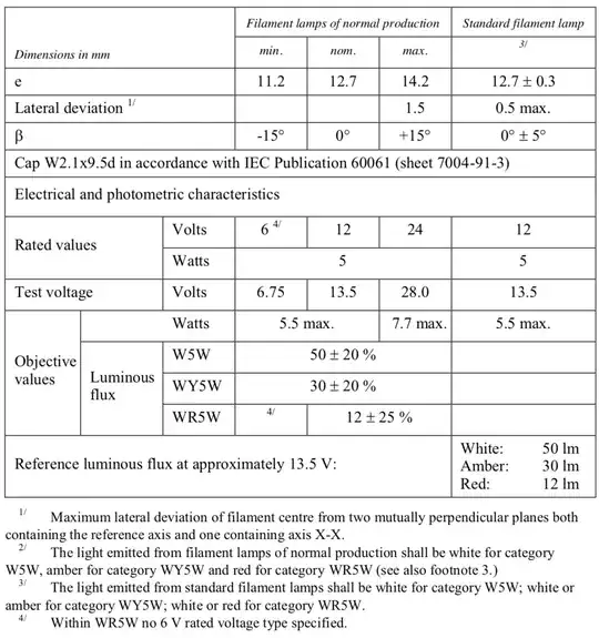

The W5W defines the bulb "category", which is the standardized filament lamp design, as explained in ECE Regulation 37.
There is no explicit mention of the first "W" referring to "Wedge", but all bulb categories that start with a "W" share the same wedge-style base in the linked document.
Incidentally, W3W and W5W have the same dimensions, the former rated for 3 W output, the former rated for 5 W.
W5W Table
