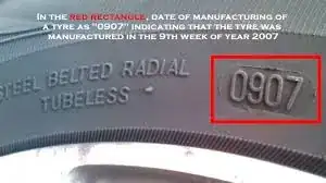

Check the tyres for any signs of cracks on the tyre wall, or near the tread. This can indicate the tyres age and/or condition. You can also check the date the tyres were manufactured, follow this article for a guide. A general life expectancy of tyres is usually 5 years.

Check out the production date on your winter tires:
If they are more than 10 years old, they have probably hardened to the point there's little difference in grip compared to summer tires. Replace them, or put your summer tires on and refrain from driving when it's +3°C or below outside.
