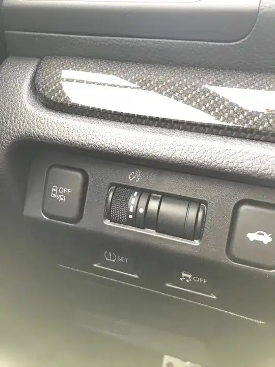

This is an undocumented navigation "feature"(?).
The night mode is disabled if the dashboard lighting is turned to the maximum. According to my mechanic this is the same for other models as well and might be fixed in an upcoming update.
You can find this solution in this forum entry as well.
To fix the problem, simply turn down your dimmer to not be on maximum level. In my case, the control is located to the left of the steering wheel:
If you want to keep your dashboard lighting to maximum level, you will need to manually switch the day color scheme in your navigation settings to darker colors, whenever required and hope for this to be changed in an update.
