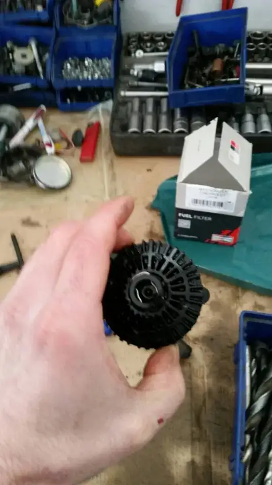

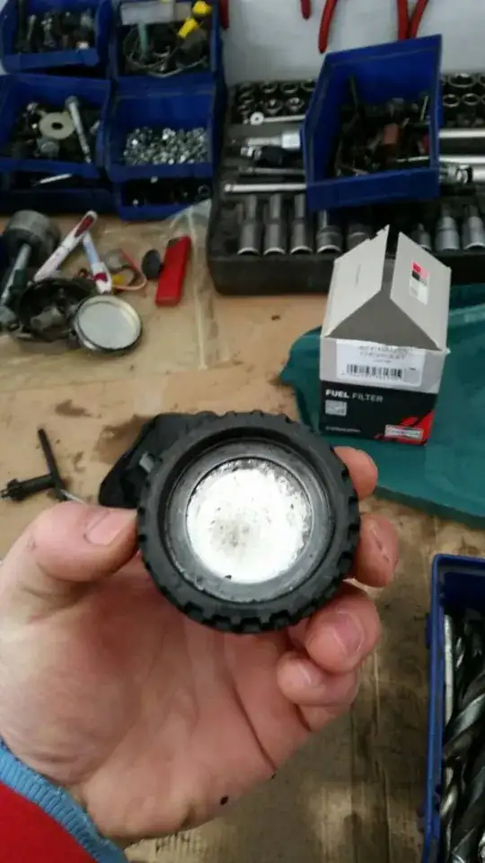

A part in the gearbox of my 2006 Renault Megane 1.6 l broke so the service needs this part to repair it.
It's placed somewhere in the clutch, gear, cylinder system.
Problem is I dont know how is this part called so I cant search to buy it online?
How can I find out the name of the part so I can buy it online? Can anybody help?

Your best bet is to look at a good clutch assembly diagram and find the location that the part came from. In a shop service manual for example they will usually have a reference table that lists the part number and factory part name.
Otherwise I’d recommend waiting for someone here who knows Renault specifically (or really knows transmissions and clutches) to give you pointers.

This is the exact catalog number of the part.
Its a membrane in the clutch system.
Here also the link in German
I'm still not sure about the exact name but an online store told me that it is a membrane in the clutch system.
So, I guess that marks it as solved. Also, its a manual transmission issue.
My Megane will be healthy and happy again :)
