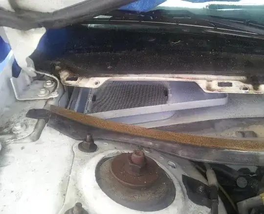

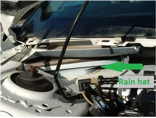

-- Water overflow at the rain hat. When it rains, a lot of water goes into the passenger compartment air inlet area at the base of the windshield. Air goes in, then travels across the top of the cowl and enters the passenger compartment directly in front of the passenger. There is a water separator system there. There will be a metal or plastic flange that stops water from entering the car. We always called that part the rain hat. Here are a couple of photos. That part is put on the car when the sheet metal is welded up. Its tightly sealed to preclude leakage. The rain hat stops water, so long as the rest of the cowl area drains. I've seen cars where the cowl drain got stopped up with leaves, water filled up and went over the top of the rain hat. When it does that, the water drips on the floor right in front of the front seat passenger. (if you told me you park your car under a tree that drops leaves and seeds a lot, this is where I would start my troubleshooting...) (Do you park your car routinely in such a place?)
Rain hat
Rain hat too
