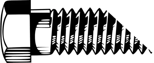

I ended up partially grinding down one side of a bolt of the same size/threading. I was able to place it in the hole matching the deeper threads, then driving it all the way in to recut the outer threads. I was then able to get the original bolt back in, hopefully it stays in.enter image description here
