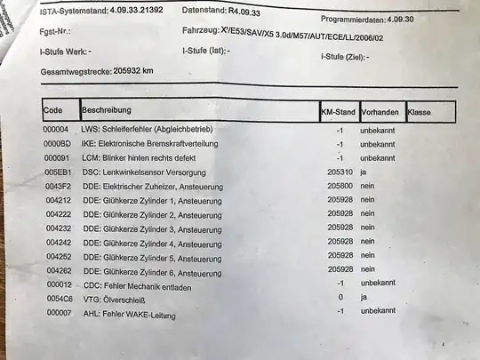

Our favorite car mechanic go through the error logs but couldn't find something specific. He told us to go to a BMW service and let it be tested there. This was BMW's log: (if necessary I could try to translate it, just tell me.) enter image description here

Here are my observations (kudos to Myself for providing translations):
  1. DSC: Lenkwinkelsensor Versorgung [Steering angle sensor power supply]
    LWS: Schleiferfehler (Ableichbetrieb) [Slider error (calibration)]
    It seems that the steering angle sensor is not being supplied power as it should. This error was set about 500 km prior to the vehicle's reported current mileage.
    This is the source of your steering-wheel-clicking sound. I know because I had a similar experience on my E39 BMW (though I never got round to fixing it).
    It appears that this fault also explains the strange behaviour of the Dynamic Stability Control. Weather-permitting, I would strongly recommend you to disable the DSC until this issue is resolved. If I remember well, the steering wheel clicking sound should disappear when DSC is deactivated.
    The code could mean one of two things:
    • The sensor is kaput due to an internal open circuit (likely, given the well-documented failure of this sensor)
    • The sensor's power supply wiring has an open (not likely, but remains a possibility)
  2. DDE: Elektrischer Zuheizer, Ansteuerung [Supplemental electrical heater, control]
    DDE: Glühkerze Zylinder X, Ansteuerung: Glowplug cylinder X, control
    This appears to be a separate issue, stored around 130 km prior to the vehicle's reported current mileage. It looks like the glow plug control is not as it should be.
    There isn't enough information here to guess what could be wrong here, and my familiarity with diesel systems is very limited.
  3. The status of the other error codes is unknown (except for the transfer box oil which Myself has already addressed in his answer). They are not critical to the functionality of the vehicle.
