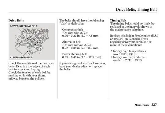

  • Squealing belt appears to be the alternator or power steering belt, based on this diagram. Power steering works fine and the belt felt firm. I didn't check the alternator belt because I didn't know it was right there until I came inside, but the battery is holding a charge fine.

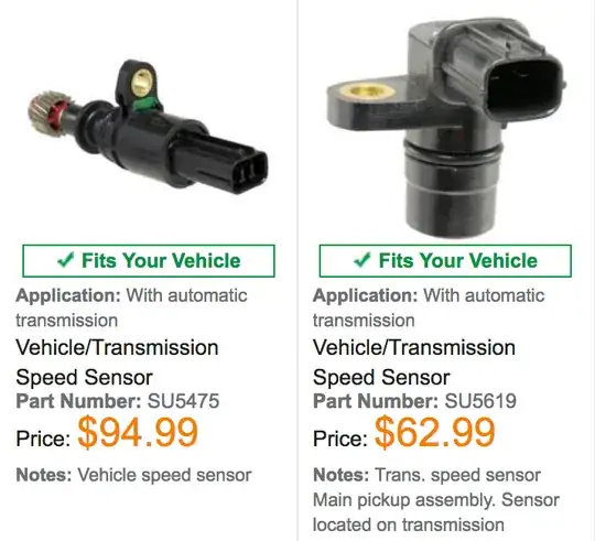

  • No tachometer, uneven idle, and strange engine speed control suggests perhaps a sensor is busted. I found two, but am not really sure which to try:
    Seems like the one on the left is probably for the speedometer and the one on the right probably sources to the tachometer? This could explain the uneven idling and refusal to shift. This wouldn't explain the temperature gauge showing zero though, and I don't get why it would make a belt slip.
