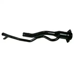

There is a trap for lack of a better word to describe in a lot of filler necks to prevent siphoning of the fuel. On the back side of where you put the fuel in you should see two hoses, one large and one small. Take the small hose off at the filler neck and use that as the entry point to put the hose in.
The picture below is a typical fuel filler neck, you can see where the hoses attach, you can pull either of them off, but depending on the fuel level pulling the large on off may spill fuel.
