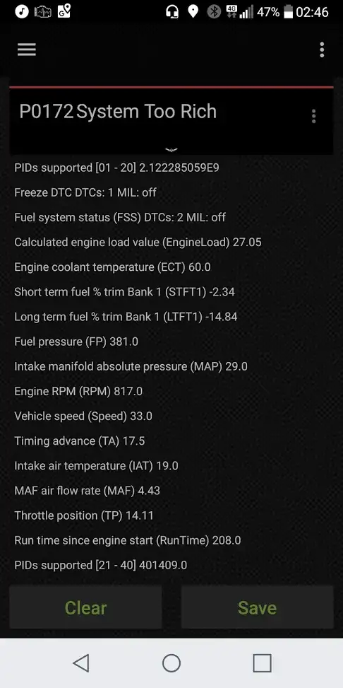

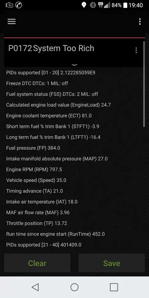

So I've got the P0172 code on my Volvo S40 2007 2.4L gasoline (5 cylinder).
The car runs absolutely fine: no unusual noises, fuel consumption is fine (terrible but that's usual), power is also fine (WOT on second gear feels as it should).
I thought to myself it's a glitch so I reset the code and it happened again.
On both occasions it was at about 35 km/h when the engine was idle (it's an automatic so it likes to idle on low speeds with no throttle input, that's usual) at the exact moment I applied light throttle.
I know this because it happened twice and I remember the exact moment it popped up and also because I looked at the data in the OBD2 reader (attached screenshots of both instances).
The only thing I found flunky is the STFT and LTFT, they seem way too low, however I don't really know what they mean and why that might be happening.
I drove around on some highways and found that the LTFT is normal (around plus or minus 3) and while idling (stoplight) it goes to minus 10 to minus 20.

I also played a bit with the OBD2 looking at MAP and MAF readings and they seemed okay (they also seem OK in the codes attached) so it's probably not them (???)
