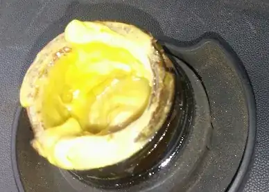

This weekend, I removed the cap to add oil (I was a quart low), and found this yellow pasty buildup, the consistency of mayonnaise. There was no trace of it on the dipstick.
yellow goop where I add oil

EDIT: Consensus from people I've talked to agree that this is condensation, more noticeable now due to cold weather and short trips. I'll clean it out and go for a drive, and then report back. Thanks!

That looks like quite a bit more than the linked questioner had.
I'd say head gasket failure, but if you only do short trips then it's possible that it's simply condensation. Take it out on the highway and let it get really hot.
