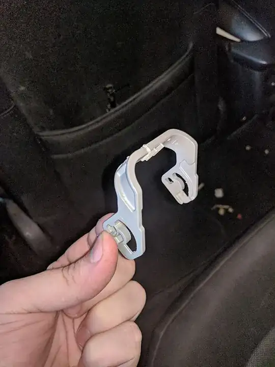

  1. The clamp on the seat wiring box was snapped in the center in which I attempted to super glue. This part I assume kept the connections nice and snug. Could this be a loose wiring issue? I had clamped together the part with one hand and attempted to move it forward in which it continued to pivot. Wiring Clamp

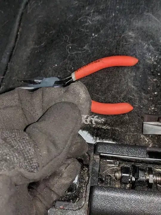

  2. I wanted to loosen the chair, but it has a "D10" torx socket? I'll have to pickup a Torx socket set to try this out as I do not own one. I hope that by loosening the chair, it will be enough to break out anything or observe anything that might be obstructing the track that I was not able to see since the problematic track is not very visible as it's next to the center console. Torx Socket

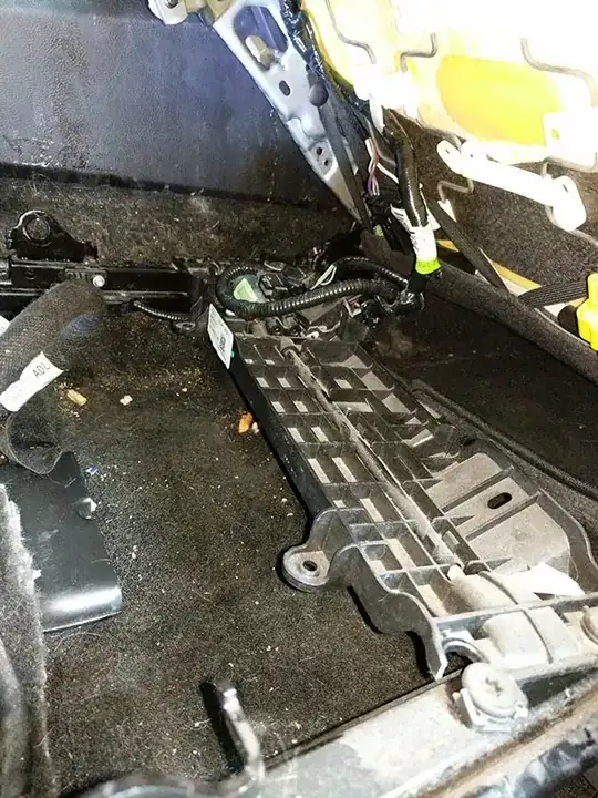

  1. After taking out the seat, it was much easier to spot the problem. I had a look at the motor first to see what was going on:
Seat Lifted

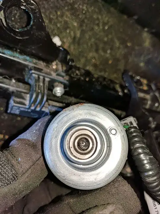

  1. I then took apart the motor to see what's going on, luckily the problem "fell" as soon as the motor was slightly moved:
Snapped
  1. I then looked inside the motor to extract the piece to see if I can reuse this motor:
Inside Motor

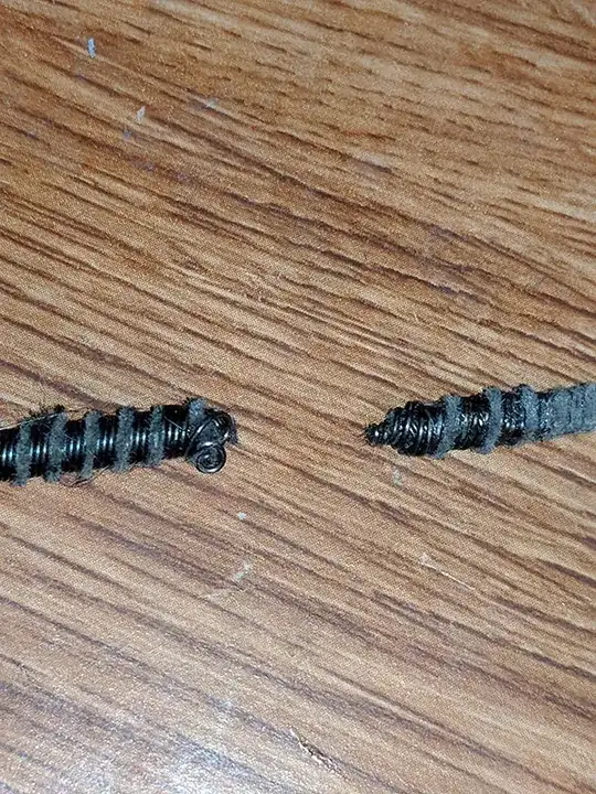

  1. I was able to extract the twisted off piece of metal:
Snapped Metal
