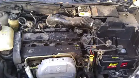

Engine with valve cover removed from far away Engine from far away

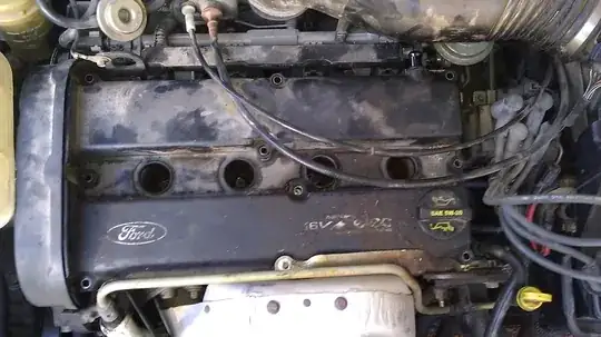

Engine close up after unscrewing enter image description here

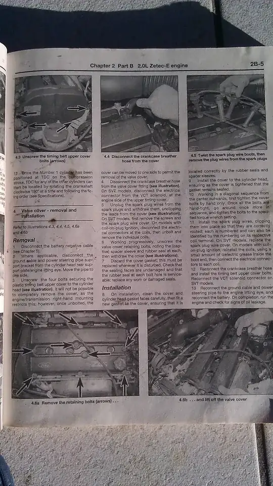

Repair Manual Instructions (Haynes) enter image description here

Make sure you got all the bolts. I'm only seeing two holes on the bottom row (should be three, right?). Make sure nothing else is screwed into the valve cover that could be holding it down. Hilsons is right about your manual saying to loosen the timing cover bolts. I managed to get one off without doing so (different year/vehicle) but it probably made it more difficult.
Get a rubber mallet and tap the cover gently to loosen the the gasket. You're not going to be able to pull the valve cover straight up because of the timing belt cover on the left (if you're looking down at the engine standing in front of the vehicle). Start trying to work the right side up a bit and once you've got a gap, use it to break the rest free, then take it out to the right and up. It's possible there may be a few blobs of silicone sealant applied which could make it extra difficult to break free.
When putting the cover back on with a new gasket, watch the torque. You don't want to break any bolts off. You are looking to put inch lbs, not foot lbs of torque on the bolts. I've got a factory manual for a different year (and a different platform), but I think it's about 7 newton meters of torque. Double check that figure with your manual. Too much or too little torque and it will leak.

It looks like there's a metal plate in your photo still covering part of the valve cover closest to you. I'm betting that's part of your problem. It's also worth noting that in your repair manuel, the upper timing belt cover is also removed first.
