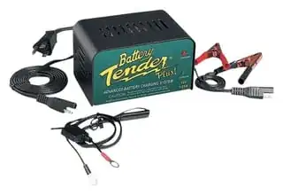

Similar batteries are used for motorcycles, and many people don't use those very often at all. They sit in the garage for months at a time until the weather is just perfect for that 20 minute ride. Batteries that just sit in the garage loose their charge, and when the voltage gets too low, real permanent damage can occur. The situation is the same as yours, and there is a solution.
In the picture is a "Battery Tender" trickle charger/maintainer. It's a popular brand, but there are certainly others. This is made for car/motorcycle batteries that are not used often. It monitors the charge on the battery and "maintains" it. It's made to never overcharge, and keeps a idle battery ready for use. I've used this on motorcycles and cars, and the batteries start the car right up when it's needed.
