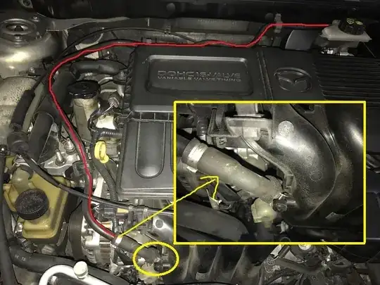

I have heard a lot about Sea Foam and would like to try out in my mazda 3 2010. I am planning to put a can in the Gas Tank, half a can in the Crank Case and remaining half into the intake through vacuum line. Unfortunately I am not very sure about the vacuum line, please help me if the following is the Vacuum line which can be used for the same. My earlier plan was to use the Sea Foam spray through throttle but unfortunately spray is not available in the Philippines (only motor treatment is available) enter image description here

I would not use the vacuum line shown in your picture. The reason being, it looks to be plumbed off of only one intake runner (supporting a single cylinder). While this would work good for a vacuum source, it won't do for a SeaFoam treatment. If you were to use this, you'd only be supplying the SeaFoam to a single cylinder and not to all of them. You need a vacuum source which is common to the plenum (large area just before the intake runners). This will disburse the SeaFoam throughout. If this isn't available, you'd need an alternative method, such as using the engine treatment through the throttle body (as you mentioned), but using some sort of makeshift spraying apparatus to inject it into the intake stream.
For a little more insight into SeaFoam, you can read this answer.

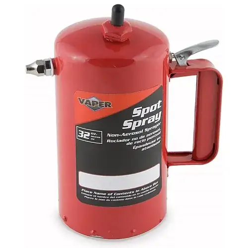

You could try using a device like the one below to spray into the throttle body. It uses compressed air rather than aerosol propellants, and so is safer for the environment and likely available in your country.

I finished sea foaming today and pretty much followed the suggestions mentioned above. Yes for a 1.6L engine the vacuum line shown above is through only 1 cylinder and may not properly disburse the liquid to all the cylinders.
The Vaper Spot Spray is an excellent tool and similar ones are available on Ali Express, which are smaller in size but built for similar purpose.
