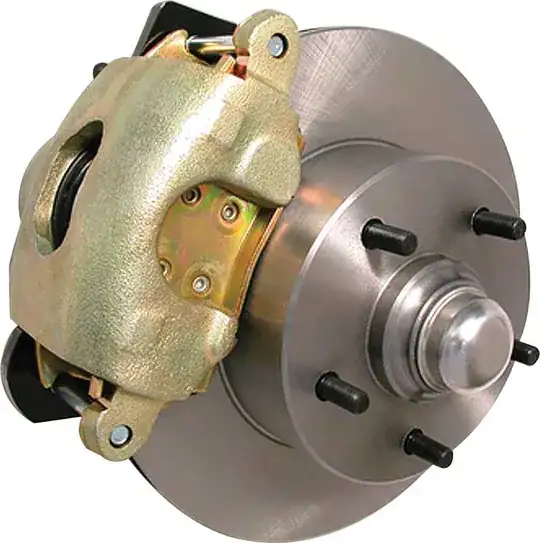

front disk brake assembly with "spindle" cover
One winter (1978) I drove my then 11 year old car over the Cascade mountain passes in Washington state many times and for some reason I didn't have hubcaps or wheel covers on the front wheels. Before the snow was gone, I had to replace the wheel bearings on the front and I believe the reason is that slush (maybe salt?)was able to penetrate the "spindle" cover. Maybe the "spindle" covers were loose (they are a force fit and had been removed several times for brake work), and maybe there was another reason for the wheel bearing failures, but I think hubcaps or wheel covers provide added protection to the "spindle" cap. (I don't know the actual name for what I am calling a "spindle" cap.)
