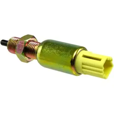

I'm posting for future people that have this issue. So I had this issue today with my standard transmission car and none of the answers that I found online was actually the issue. It ended up being an issue with the clutch safety switch.
Before you go out and spend a lot of money follow this checklist.
  1. Check the battery
    a. Are the headlights coming on and are they bright? If they aren't it could be a battery issue.
  2. Is it a manual transmission?
    a. If so check the clutch safety switch. This is found at the top of the clutch pedal. Clutch Safety Switch
That black peg has to be pushed in for the car to start. In my case at the top of my clutch pedal there was a rubber piece that was in the metal that pushed it. However, it go destroyed and broke off, that's why my car wasn't starting.
